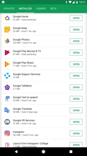

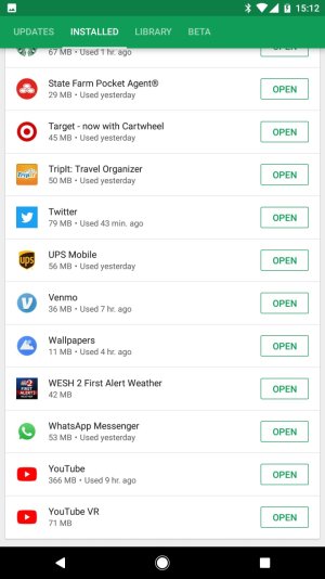

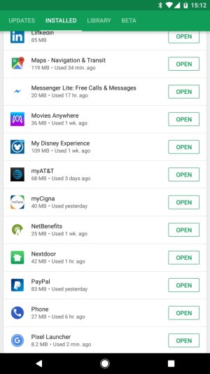

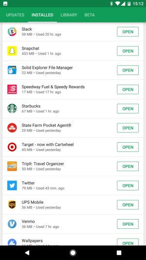

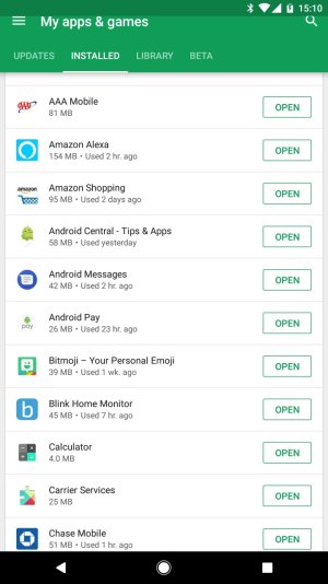

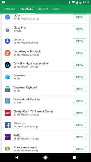

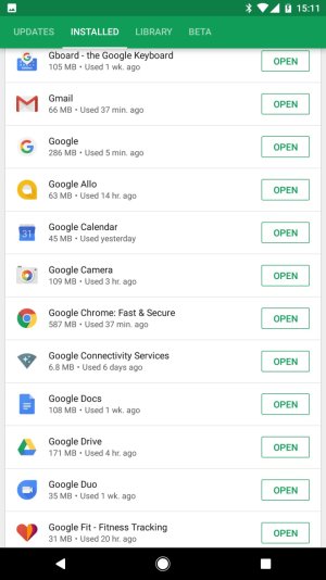

I thought so too. I've attached screenshots of the apps installed. I so not have anything crazy or out of the ordinary.
Screenshot_20171020-151049.jpgScreenshot_20171020-151058.jpgScreenshot_20171020-151118.jpgScreenshot_20171020-151125.jpgScreenshot_20171020-151202.jpgScreenshot_20171020-151211.jpgScreenshot_20171020-151217.jpg
