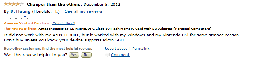

I've found this review on Amazon... is it possible that TF300T cant read microSD-HC ?? and can read SD-HC on docking station... just sounds riddiculous...

Whoa whoa whoa. Whoa. I've been using a 16 GB microSDHC Class 4 card, no issues whatsoever. Have you tried your card in something else? Could be a defective card.
