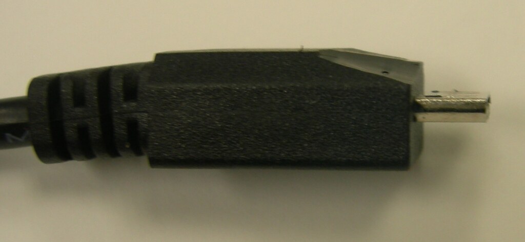

So I've had a few problems with the MicroUSB port on 2 Captivates. The cables seem to fall out way too easy.
The problem is the recessed port. If you look closely, there's a ledge (piece of plastic) on the back side of the inside of the port. This tends to prohibit a snug connection because the rubber/plastic of the USB cable hits that edge before the metal (male) connector can fully seat into the metal (female) port.
Since I buy all of my cables from Monoprice I decided to experiment with a $.80 cable.
I took a razor blade and shaved the bottom side of my MicroUSB cable (the wide side) at an angle. By doing this my cable seats further into the port thus provided a snug and tighter connection.
Curious, does the OEM cable that came with it fit right or is just a thing with aftermarket?
The OEM cable that came with it is much thinner (rubber block housing the connector). So that's why it fits better then the other cables.
Either way that recessed port is a bad idea but at least I can easily mod my existing MicroUSB cables. :p

Here's a photo of what I did with a razor blade and about 10 seconds. Notice that the angle is around 45 degrees from the previous 90 degress.
Wow that is a huge micro-USB connector housing. None of the cables I have are anywhere near that thick, that includes two samsung, one nokia, and one more generic one.
