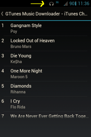

Cannot Find the settings for status bar tweaks or anything under sound or headphone settings in my music player....
how do I change the headset icon color to blue to match the rest?!
I could've swore it was in the CM menu settings somewhere,but not.
Just a minor annoyance and I'm picky:)
I will attach a SS shortly...
I'm pretty sure there's no way of changing the color of that icon on CM without decompiling your systemui and changing it yourself.
Is this CM7, 9, or 10?
Tapatalk? from my Optimus V
Cm settings > interface > status bar tweaks
Yes, there's an option to remove the icon but not for changing color...
The icon was actually GREEN at on point along with 3G and all that before I re-themed.

your reply is probably right ;)--& it's 7
doesn't it show up on my info to the left??
no big deal just thought it may of been somthing simple I might of missed.
maybe some "re-theming" could fix this as you are saying it's de-compile/system/ dev thing ;)
Rom toolbox has the option to change color I believe

Go for it. That's really how I got into theming. I wanted to change my statusbar icons to look like the ones in Suave HD, and I loved doing it and have been doing it ever since.
I assume you're using BACKside if it was green at some point. That is probably because you flashed the Green Machine Theme. That swaps out your framework and systemui for ones where everything is green. It looks like you're using an ICS theme now though. That is actually what that PNG looks like in ICS just fyi.
