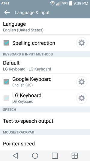

This is my first post. Normally I'm pretty good with this stuff but this problem evades me. I just got the LG G3 about 2 months ago. For the first 6-7 weeks all was good and normal. About a week ago, I went to "speak" a text msg like I've been doing up until then where the microphone icon has gone missing. I'm sure as I was playing with setting, along the line I must have done something I shouldn't have taking away my microphone icon. I've tried a few things but can't seem to get it back. Seems that the area I need to get to, to turn it on, is grayed out. I've attached a few pics. If anyone can help, it would be much appreciated!

Thanks for the reply. These are my options under "Settings, Language & Input, Keyboard & Input Methods" I don't seem to have "Google Voice Typing" :/

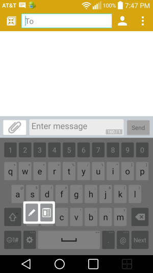

This worked for me on an LG G4 with Android 5.1 running.
Go to Settings\General\language & input\LG Keyboard click on picture of Gear\click Keyboard height and layout\click QWERTY keyboard layout\A picture of the keyboard spacebar will display with a highlighted symbol to the left of the spacebar (it could be a pencil, a gear or a clipboard). Press that highlighted symbol ie. For example, if its a picture of a gear, press and release the gear and a picture of four symbols will appear Microphone, Pencil, Gear and Clipboard. Just choose the Microphone. It should now up on your keyboard next to the spacebar.
Re: Missing microphone for speech to text
Thank you so much - this worked perfectly. I was so frustrated; I didn't realize I could click the gear on the keyboard picture.
