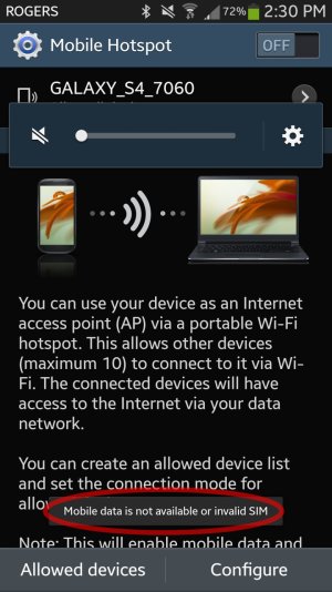

I have a Verizon s4 used on T-Mobile plan. Everything else worked but the hot-spot feature. Any 3rd party apps I could used to get around for it to work? I have android 5.0.1 installed. Thx.

This will work, it has worked on my note 3 AT&T unlocked device that I switched to T Mobile. I had trouble with Mobile hotspot, it kept reading "Invalid Sim" and found out how to disable this, but it has to be rooted first! (preferably towelroot Android 4.4.2).
1. Download Titanium Backup from Google Play store (allow apps from unknown sources on device)
2. Since your device is assumed to be rooted at this point, search "tether" in the Titanium Backup app.
3. You should see "TetheringAutomation" and "TetheringProvision". These are what is messing up your tethering experience; Uninstall these apps, but back up for safety before you uninstall.
4. Download "Hotspot Toggle widget" from Google Play store, put the widget on your home screen.
5. Press to activate the widget, IMPORTANT: you will have to press the widget 3 times to activate mobile tethering for whatever reason, at least that how it was for me.

5) Get ES File Explorer from the Play Store. Tap the hard key for menu, scroll down and tap on Net Manager. Tap on Settings at the bottom, select 'Use the system AP setting', enter an SSID (recommended to be short with no spaces, like 'MyName_GS4_Active'), and a password. Tap on OK. Tap on the back button. Tap on 'Create a hotspot network'. It will say 'Establishing Network...turning on', followed by 'Now you are using AP, SSID is...', AP password:, and an 'Exit' button. It may say 'Unfortunately, Settings has stopped' after this, but IGNORE it. Your hotspot is still active - look at the top left of the phone, you will see a wifi symbol in a blue icon, this is your indication that your hotspot is working. WORKS PERFECT!
Doesn't work. Still get "Mobile data not available or invalid SIM"
#2 Do not have "All" tab.
Should have. When you open Application Manager, it should be showing "Downloaded". Swipe your finger on the screen to the left so it changes to a different list. Do it 3 times. It should go from Downloaded to SD Card to Running and then All.
