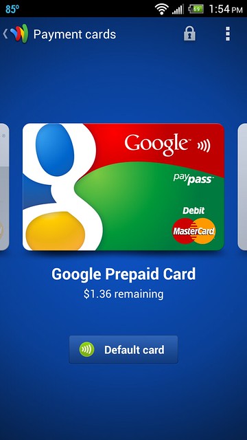

This first screen starts with the W in grey scale and animates to color after your phone has been read by the merchant:

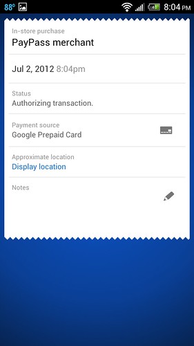

This is the following screen if all is going well. Actually, even if it isn't. I got this screen when the grocery store register said "RFID payment system not setup blah blah."
