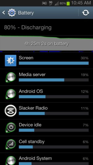

By off... Do you mean the screen was off (phone locked) or off as in holding the power button and doing a power down of the phone.
I am assuming you mean you just had the phone locked and the battery drained a ton. Next time you get a full charge let the battery run down again and go to system settings > battery to show us what's using battery (look below for an example of what the battery statistics look like... Yours will differ from mine)
Sent from my Sprint S3 using AC forums
