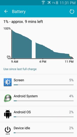

Second of all, my battery life is now terrible. Full charge in the morning, put it in my pocket with no sim card in the phone, airplane mode. By noon it drained itself to 60% with the screen off the entire time. By evening it was fully drained. I would estimate only about 20-30 mins usage total, the rest of the time the screen was off!!
Opening the battery monitor also shows weirdness. No apps are shown as draining the battery. Doesn't make any sense to me at all?

If neither of these is an option, try a new battery. And track your battery stats in more detail. If you tap on the battery graph you'll get a breakdown, screen on time, wake time, GPS, etc. Likewise tapping each item under the graph in main battery menu gives you additional details.
