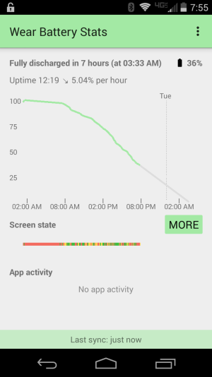

Hello everyone,
I've been reading around the forums, and I can't seam to figure out, what people are doing to get their 360 to last all day. Are you guys running any types of apps, different watch faces, or is it just stock like it came out of the box?
My battery seams to drain relatively fast, especially in the first 10%. I have had, a few apps installed, like facer, calendar, calculator, wear mini launcher, wear battery stats, blue colony, and a few others. I've uninstalled most of them, I still have calendar, calculator, wear battery, and wear mini launcher.
I took my watch, off the charge at 1630 and it is now 2135, as I write this, and my battery percent is at 68%. I have not really used it to much today. I checked wear battery stats, and it says that i am discharging at a rate of 6.24% an hour.
I have even done, a complete reset of the watch, and it still seams to have this issue. Am I missing something here? Do you think, that it could possibly just be a bad battery in the watch, should I think about replacing it with another one?
Sorry for the long post, any help would be greatly appreciated!
