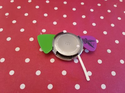

I watched a few videos online and used the Mr fix it guide to work out how to install it and using a few tools I already had (small watch screw driver, guitar picks, tweezers, pin, plastic toothpick, pen knife and hair dryer) I was able to swap out the battery.
One thing I noticed none of the guides mentioned is when you remove the circuit board from the watch housing there are 4 little plastic spurs that drop out. These are used to secure the circuit board inside the watch housing and slot into grooves in the metal housing. However its literally impossible to get them back in when you re-assemble the watch, so I had to leave them out. Initially this didn't make any difference though I do now need to buy some adhesive to reseal the case. Also another issue I had which is worth noting is that the connectors are very small and fiddly and you must make sure they are fully plugged in otherwise the watch won't switch on. At first I thought the replacement battery was duff but then I took the watch back apart and noticed I didn't have it fully plugged in. The battery also required charging once installed, even though it had about 27% power it needed the initial kick from the charger to make it switch on.

First one is me removing the back off the watch (I heated it up for about 5 minutes with a hairdryer to loosen the back off):
