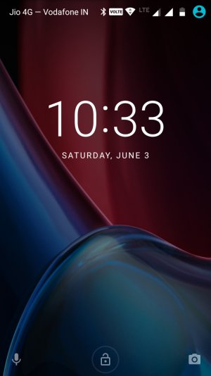

Hi, i am also facing the phone lock issue, so i have put security pin lock, my phone doesn't lock sometimes so it doesn't ask for pin when i swipe to unlock. It shows an (un lock symbol ,pic attached) when this issue(no pin when swipe to unlock) happens, and when i press that symbol then it locks up my phone, which setting is it?
I was also facing the same problem in my g5 plus.In my mob , after the display gets off (sleep duration 30 secs) and then when i press the side home button, the mobile diaplay gets on to home screen without even asking for password. Instead i have set pattern in my phone security setting. My mobile was not safe at all. I had 2 keep my mob switch off 4 protection from other people.
Well i had got the solution, everyone facing this problem might have made their smart lock on. So so go to SECURITY> TRUST AGENTS > SMART LOCK and disable it. It will work perhaps.
Guys while trying all the said above steps my phone(Moto G4 Plus) still had issues after sleep and was not locking itself.
Then after many tries, figured a thing, My phone Security Screen Lock was a PIN and this option doesn't have automatic Screen Lock timer. Changed it to a pattern and that worked.
Hope this helps
