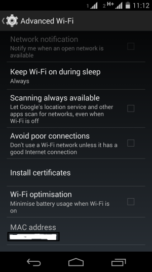

Settings / wifi / 3 dots /advanced
Check if your avoid poor connection if on
If so, turn it off

If anyone still has wifi speed issues on Moto G, the following could be helpful which fixed the issue for me.
1. Phone - Location services ON with High Accuracy mode. Battery Saver Off (under settings>Battery). WiFi advanced settings as per the above screenshot.
and now the culprit router..
2. Router - Band has to be 2.4Ghz only. Change the settings for 801 b/g/n to either b or g. (Also if required, change the channel frequency from Auto to something else.)
Restart router and phone and now the speeds are back...!! No more buffering while playing videos.
