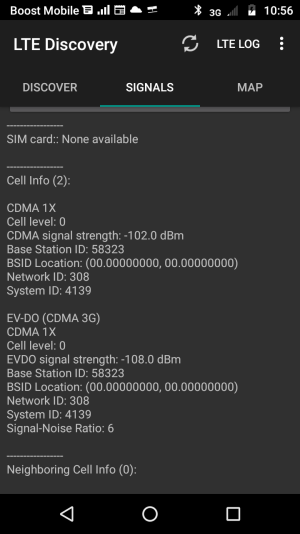

What model specifically? What carrier? What signal type (LTE or GSM or CDMA)? If you install an app like LTE Discovery, what is your dBm signal level?
So you're on Boost Mobile, but can you still tell us the exact model number of the phone (in Settings>About Phone)? The reason I ask is that some phone variants might not support the carrier's network bands fully, and therefore give you worse signal.
