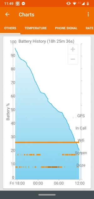

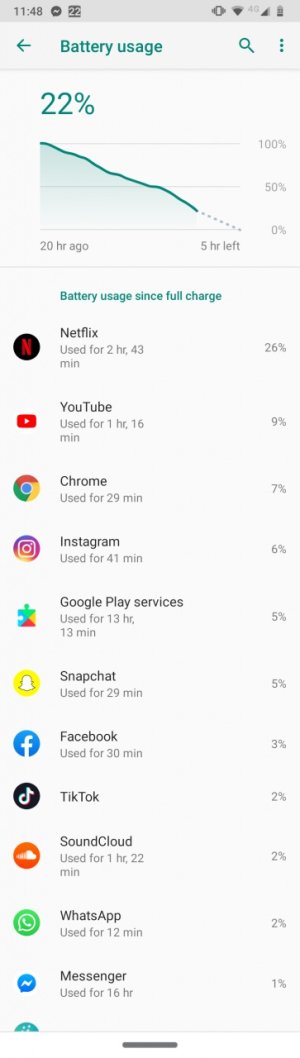

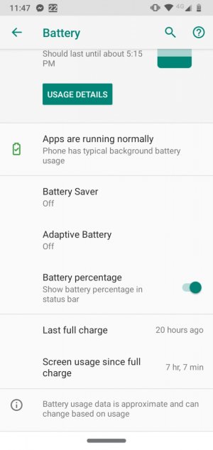

Here are the results
Are you saying that when you got the phone, it routinely gave you 15 hours 30 min of total screen-on time?
Can you show us the Phone Signal graph in GSam?
