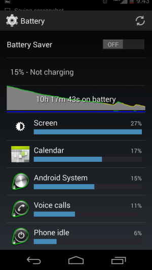

ok so as promised, i took 2 screen shots of what my screen looked like today. In general, my battery was pretty decent throughout the day, I just feel like somehow i could get more battery out of it, at least a little bit more battery power. Screenshot_2014-03-02-21-43-41.pngScreenshot_2014-03-02-21-43-37.png
That does not look normal. Is your calendar app always draining that much power?
I mean it shouldn't be..the only thing that I have on one of my home screens is just the stock Android calendar widget which helps me keep organized of course. ..

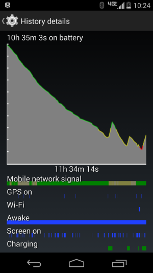

yup, absolutely sorry about that. here ya go. View attachment 106489
Ok. Thanks. Take a look at a couple things. 1. The solid bar for 'Awake'. Not good, as something is stuck keeping your device awake a lot, highly contributing to your battery drain.
And 2. for most of your day, you were on a steady decline, possibly due to the calendar.
Have you rebooted the device?
If so, how about removing the widget for a day and test again?
to be honest with you, No, no it doesn't usually it's just my display, and sometimes my Android OS. That's about it. If it's helpful for everyone on here, I'll trial run my battery again tomorrow, then post more screen shots of the results again. However, my calendar app usually does not take that much battery power...
Yeah, that looks like at least one wake-lock. It's fairly normal to have the device awake more than when the screen is on, especially since it's retrieving notifications etc to push to active notifications, but all phones do something in the background... but this one never slept.
I think OP needs to reboot one time. What I have been seeing around the forums is that Android OS has had higher battery usage since the 4.4.2. update.
