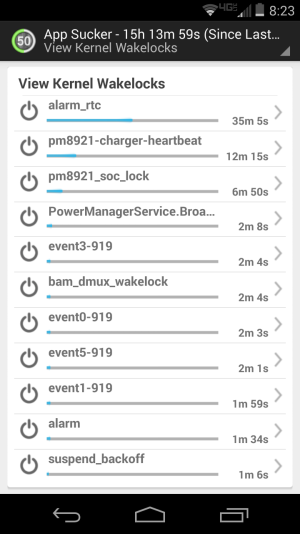

So, I've been running GSam Battery app since yesterday evening. Gave it until this morning to gather some data. Went into "view kernel wakelocks" and alarm_rtc is showing at the top of the list. Does this mean anything, or is this a normal reading?
It's not necessarily 'abnormal'...here's a decent link for a description of alarm_rtc and a lot of info to help you with all kinds of battery analysis.
Battery Drain? Wakelocks?Find out what is using your battery when sleeping | Android Does
HTH.
