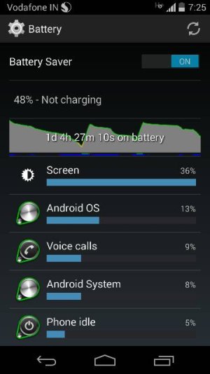

Hey a little confusion here.... As u can see my moto x here is showing here 1d 4and a half hrs of run...but it has been charged twice and its still 3 hrs to go to be 24 hrs since the first charge... So basically the run time should be around 12-15 hrs max on each charge and yeah also the phone was on airplane mode for like 3hrs...
So getting back to the point... Why isn't it showing me the info after each charge..?
Once you charge to 100%, it resets.
