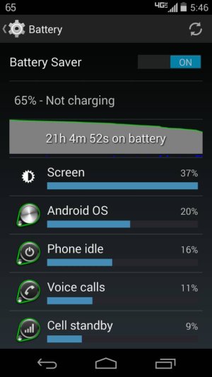

I have all three assist selections active and no change in battery life. On VZW.
Sent from my XT1060 using AC Forums mobile app
