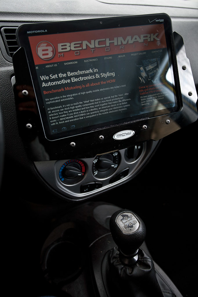

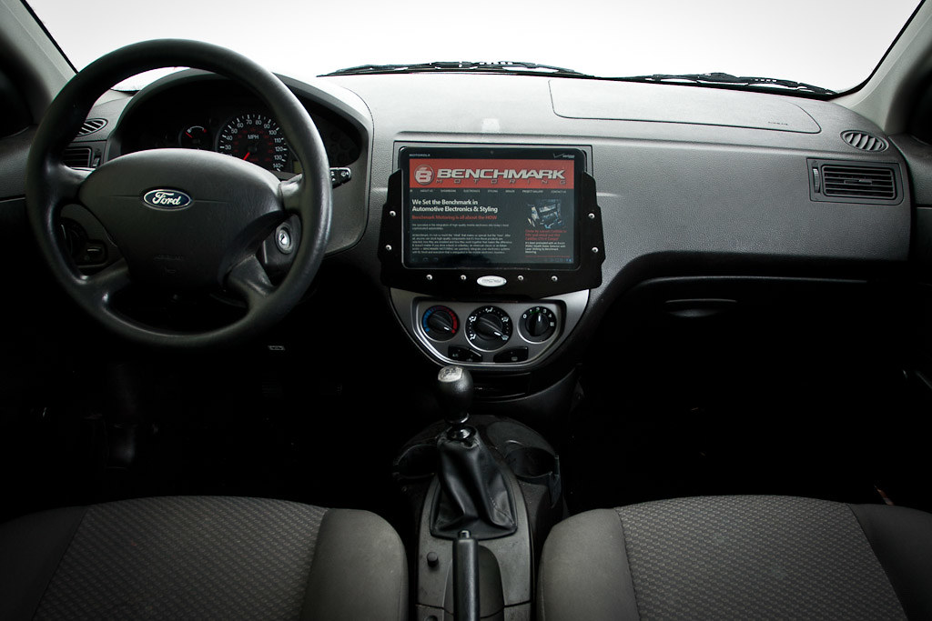

very nice job how did you get the audio out from xoom dock? i thought audio jack was on the top of xoom and charger port is on the bottom?
Xoom outputs audio via USB also.
The standard dock has a 1/8" audio out on the back.
i didnt know that thank you very much.so usb out for audio how did you convert that for your amps/volume control?
how did you get power to the dock because it was made for home charging? volts are different
1/8" audio -> RCA -> JL Audio control -> Amp
Volume control:
JL Audio CL-RLC Remote level control and line driver at Crutchfield.com
I got the car charger kit. They relocated the 12V car outlet so it sits behind the dash and just plugged it in. The car charger kit uses the same connector as the wall charger so it connects straight to the dock.

Anyone that doe something like this should be mindful of the airbags. If the airbag fires it will turn anything that's not securely bolted down into a projectile. Many passenger side airbags puff out into the middle where you'd likely mount stuff like this.
Interesting point. Never thought about side airbags... I don't even know if I have side bags. I have the legal minimum (for a 2005 car) whatever that is.

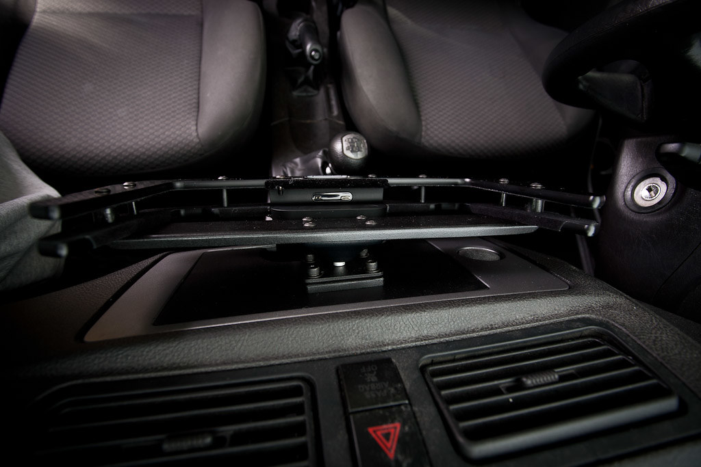

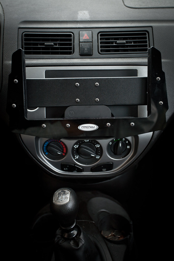

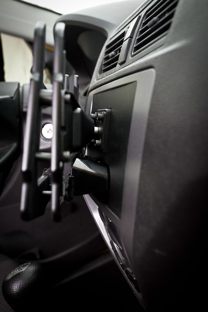

If you wouldn't mind me asking. What was the cost of the audio company fabbing the mount for you? Just want to know a decent price range so if I were to go somewhere to ask them I wouldn't get screwed into paying more than its worth. The install looks sick though!!
Realistically plan to spend $1000 on fabrication. I got about 5 installation estimates and the minimum was around $500.
I chose to just get it done right and picked the shop I felt was best qualified. I wouldn't be suprised if you could find someone on craigslist who would do it for less, but I just think that is too risky and I'd rather not deal with the potential (and likely) frustrations & compromises involved with budget installations.
I need to get photos of the work behind the dash... Its this custom welded metal contraption. When I gave them my car there was just a wide open hole in the dash, everything you see these is fabricated and rock solid. Also it can be reverted back to factory/stock, they didn't modify the car in any way.
