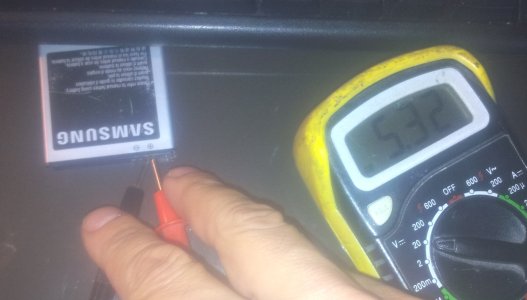

Understand that I had better not juggle batteries...but still no good answers though why phone is not booting with full batteries...
Not too much interest here...seems not too many users have this prob...anyway:
I purchased 6 new batteries...after loading them in that external USB charging port they all will only show 4.6 V on the multimeter...and the beloved bloody S2 will boot reliably every single time with any of them...so: back to the way we were
It appears the old batteries were just faulty after 2 years...
