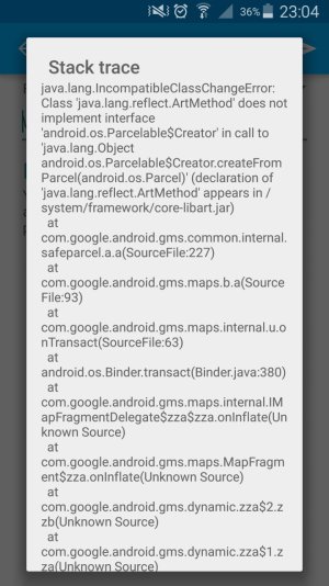

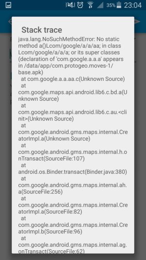

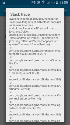

As detail, I am attaching a stack trace (sorry, only as PNG screenshots) from some of the crashes.

I just downloaded the Android software development kit, latest versions of everything. I downloaded Google Play services support, and built a minimal app that uses Google maps display (such an app is available as a template in Android Studio).
The app builds fine and gets installed on my Galaxy S5. Upon start, it crashes with the same errors that I get in the commercial applications listed above.
Code:
08-18 11:41:56.648  10307-10307/com.example.[myname].myapplication E/AndroidRuntime﹕ FATAL EXCEPTION: main
    Process: com.example.timconze.myapplication, PID: 10307
    java.lang.IncompatibleClassChangeError: Class 'java.lang.reflect.ArtMethod' does not implement interface 'android.os.Parcelable$Creator' in call to 'java.lang.Object android.os.Parcelable$Creator.createFromParcel(android.os.Parcel)' (declaration of 'java.lang.reflect.ArtMethod' appears in /system/framework/core-libart.jar)
            at com.google.android.gms.common.internal.safeparcel.a.a(SourceFile:227)
            at com.google.android.gms.maps.b.a(SourceFile:93)
            at com.google.android.gms.maps.internal.u.onTransact(SourceFile:63)
            at android.os.Binder.transact(Binder.java:380)
            at com.google.android.gms.maps.internal.IMapFragmentDelegate$zza$zza.onInflate(Unknown Source)
            at com.google.android.gms.maps.SupportMapFragment$zza.onInflate(Unknown Source)
            at com.google.android.gms.dynamic.zza$2.zzb(Unknown Source)
            at com.google.android.gms.dynamic.zza$1.zza(Unknown Source)
            at com.google.android.gms.maps.SupportMapFragment$zzb.zzwP(Unknown Source)
            at com.google.android.gms.maps.SupportMapFragment$zzb.zza(Unknown Source)
            at com.google.android.gms.dynamic.zza.zza(Unknown Source)
            at com.google.android.gms.dynamic.zza.onInflate(Unknown Source)
            at com.google.android.gms.maps.SupportMapFragment.onInflate(Unknown Source)
            at android.support.v4.app.FragmentManagerImpl.onCreateView(FragmentManager.java:2169)
            at android.support.v4.app.FragmentActivity.onCreateView(FragmentActivity.java:300)
            at android.view.LayoutInflater.createViewFromTag(LayoutInflater.java:734)
            at android.view.LayoutInflater.inflate(LayoutInflater.java:483)
            at android.view.LayoutInflater.inflate(LayoutInflater.java:415)
            at android.view.LayoutInflater.inflate(LayoutInflater.java:366)
            at com.android.internal.policy.impl.PhoneWindow.setContentView(PhoneWindow.java:428)
            at android.app.Activity.setContentView(Activity.java:2241)
            at com.example.[myname].myapplication.MapsActivity.onCreate(MapsActivity.java:18)
            at android.app.Activity.performCreate(Activity.java:6221)
            at android.app.Instrumentation.callActivityOnCreate(Instrumentation.java:1119)
            at android.app.ActivityThread.performLaunchActivity(ActivityThread.java:2611)
            at android.app.ActivityThread.handleLaunchActivity(ActivityThread.java:2725)
            at android.app.ActivityThread.access$900(ActivityThread.java:172)
            at android.app.ActivityThread$H.handleMessage(ActivityThread.java:1422)
            at android.os.Handler.dispatchMessage(Handler.java:102)
            at android.os.Looper.loop(Looper.java:145)
            at android.app.ActivityThread.main(ActivityThread.java:5834)
            at java.lang.reflect.Method.invoke(Native Method)
            at java.lang.reflect.Method.invoke(Method.java:372)
            at com.android.internal.os.ZygoteInit$MethodAndArgsCaller.run(ZygoteInit.java:1388)
            at com.android.internal.os.ZygoteInit.main(ZygoteInit.java:1183)
Please remember, this is behavior 2 days after the phone was factory reset :(
