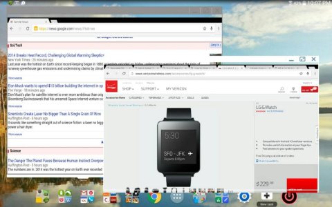

I tested the Chrome app and Chrome Beta app both as pop up multi windows at the same time and it works just fine. See the picture.
(Note: the fonts in the screen shot don't look very sharp but they are just fine in the real apps. For some reason the screenshot distorted them slightly.)
