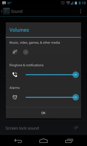

Music and media volume control. Stuck on silent?
HTCTundaBow
Apr 19, 2011
181
I cannot get my media volume to turn up. It's stuck on silent. I've tried the volume rocker, and I've tried manually sliding the volume bar with my finger. It won't move. I can't hear videos or music. What's the problem here? Keep in mind, my phone volume works fine, and will turn up and down.
Is it stuck on silent even if you unplug your headphones? I?m thinking perhaps you have volume controls on your headphones and the vol down button may be stuck or something.
This came up a while ago and it turned out to be a game app that had its own mute button. Problem was, when the game was muted, all media was muted, even when the game wasn't running.
Good tip about muted app causing this. I killed all running apps, then tried to up the media volume and it worked.
Thanks to the advice above and installing (advanced task killer) my tab is now with working sound again.
Thank you.
