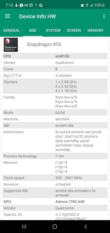

Where did you buy your phone? Are you certain it's genuine? Knockoff Galaxy phones are common on sites like Wish and AliExpress.
Use an app like Device Info HW to check the specs and make sure they're correct for the phone.

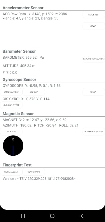

I've checked the specs of my phone and it failed on the proximity sensor test; either the proximity sensor is there (as the Device Info HW app indicated) and inoperative or it isn't their at all.
I guess it means my phone isn't brand new as I thought it is, just a used phone in pretty much pristine condition with the exception of the absent S-Pen Remote features and the inoperative proximity sensor. I bought the phone at a popular, legit local phone dealer (who is not an authorized Samsung outlet).

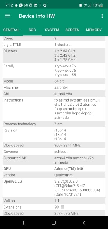

What CPU does Device Info HW report? That's often where you can tell if the device is genuine. A knockoff will almost always have a Mediatek processor.
The CPU looks genuine. I did confirm not long ago that the anomalies raising my concern on the phone are due to the fact that the phone wasn't manufactured for my country. The phone is a brand new grey-import. If it were for my country, the code string in the section titled "Service Provider Software Version" would start with "ECT_" and not "SAOMC_"
As it is, this mystery has been solved and I no longer have to worry about why certain features in the phone are either inoperative or absent, but rather ensure that when I replace the phone, I buy one from an authorized Samsund dealer.
