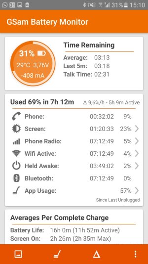

I have taken the phone in to Samsung Center in Morningside. They erased the device and reloaded the software. They've attributed the poor battery to bad network reception. My reception in the office isn't great but I am always on Wifi. I have also been in the same home and office when the battery was great, so the reasoning does not make any sense. Please find attached my battery performance for today.

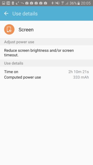

3. The Screen category (to see total Screen On time).

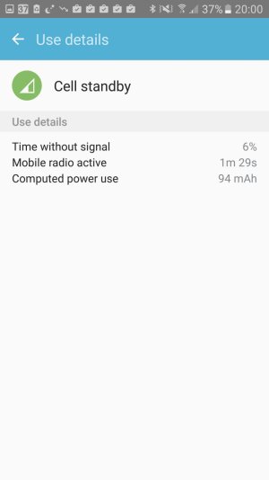

4. The Cell Standby category, if present (to see Time Without Signal).

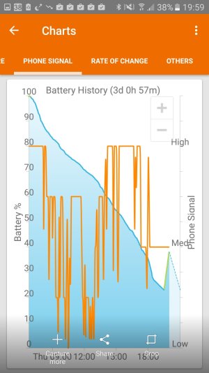

Use GSam Battery Monitor to get the Cell Signal Strength graph.
Those screenshots confirm that your cell signal is generally poor, so that's probably the main reason. It doesn't matter if you have wi-fi on while you're in your office -- if the cell radio is still on, that will suck energy as the phone struggles to maintain a good signal. You could consider turning on Airplane Mode while in your office to turn off the cell radio (after which you can still turn wi-fi back on), but of course this means you won't be able to make or receive calls, unless you use a VoIP service like Skype or Google Voice/Hangouts Dialer.
