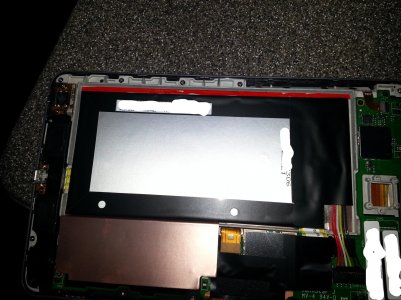

Thanks wiredfellow (*edit* sorry, I didn't pay attention to who initially figured out the battery thing) ! This was my problem as well and one added bit of info, if you look at the picture I attached here (highlighted in red), you'll see that there's a bit more than 1/4" of space in the battery compartment where the battery could potentially move if shaken hard enough in the lateral direction (i.e. the battery doesn't fit the battery space exactly). I suspect that most of these battery/charging/not turning on issues are being caused in shipment where the battery is getting knocked to the side, then the connector comes loose just enough to cause these weird issues.
That's just my suspicion, but seems like a likely culprit. HUGE thanks though because now I can play with my new toy!! My plan is to apply some sugru into the space so that the battery can't shimmy around!
