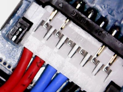

You just did a factory reset so I don't think it's a software but hardware issue which is very common in Samsung tablet: cracked battery connector.
Common problems of cracked battery connector: quick discharge, slow charging, auto reboot, auto shutdown, depending on how bad the cracks are.
Running is Safe Mode doesn't help anything to fix hardware issue. I remember that you changed a new battery but it doesn't improve battery life, this's a sign of cracked battery connector. A simple re solder work will fix it permanently.
I am speaking on professional experiences working with Samsung tablets and it's not a guessing opinion.
This is an example of a re soldered battery connector, more solders added to secure the connection

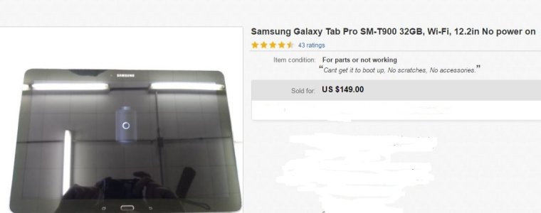

I just bought a Samsung Tab Pro 12.2, from a guy doing computer services, for only $160. It cannot turn on or take charge as he said.
I opened the tablet and inspected the battery connector , it looked normal at the first look under microscope, but with a gentle push, the battery connector was moving.
Bingo !!! Problem solved. The re solder work only takes me under 10 minutes, and now I have a look like new Tab Pro 12.2 for only $160 . This tablet is quite new but its battery connector already broke off from the board, so don't expect good battery connector with used or old tablet.
