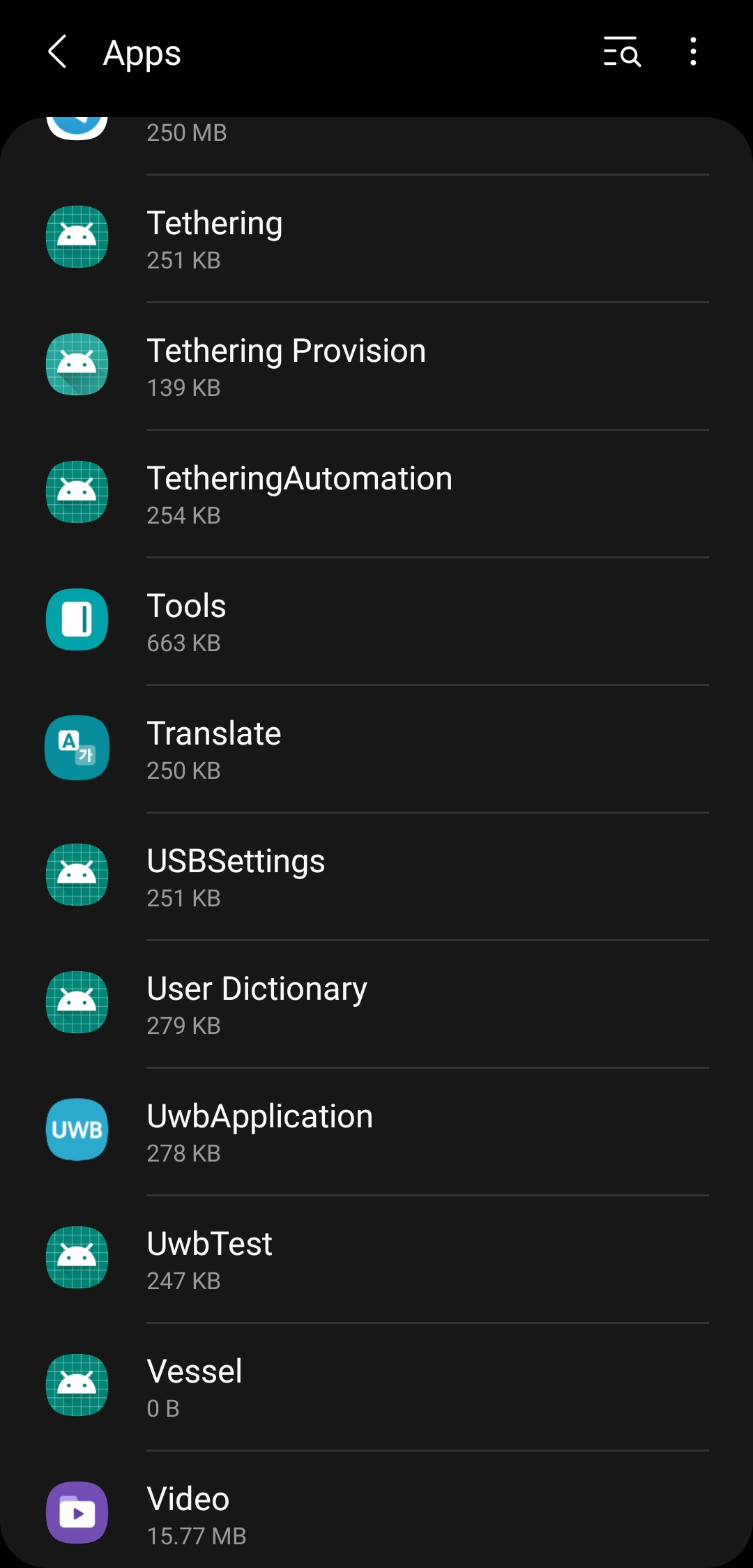

Try going settings>apps>toggle on system apps then hit ok >search usb settings on the list and clear its data and force stop see if it helps
