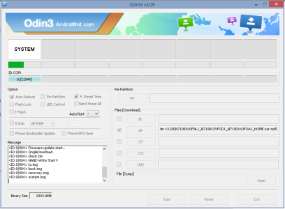

I run it in the safe mode but as it opens . i just unlock the screen it freezes and reboots and gets me out of safe mode
shall i send it to Samsung services or there is another solution ?
Re: My Samsung Galaxy Note II (GT-7100) restarts automatically
I don't have direct experience with Odin, not having owned a Samsung device. Let me see if someone else has any input.

Glad it's working now! What happened--did the flash finally finish?
Actually , the problem was with my laptop .. i didn't shut it down for more 20hrs ( Downloading and installing GTA V ) :D .. and i didn't apply the windows update so it was lagging and every time i runs ODIN it stuck :D
