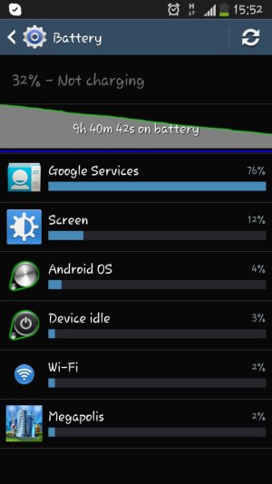

Strange, I've been using my S4 for 3 weeks now and really surprised with the battery. During the first days I wanted obsessively empty the battery before recharging and it was hell lot of a work to drain the battery. For example after yesterday the battery level was over 50% so I didn't want to charge it over night. And honestly I think that use my phone during the day quite much compared to others around me :)
(I have basically everything on, wifi, mobile data, gestures, auto brightness on etc. and definitely not using power saving)
Only once there was a bug with google service app and it had drained the battery during the day. It was only once.

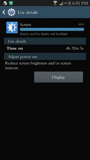

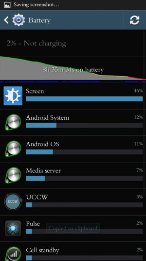

I have Google Now off, and all features off except Air View...you can easily turn the ones u want on by dragging 2 fingers down on the notification bar... Also 30% brightness... U will be a very happy camper... I feel like I could do better though
Sent from my Galaxy S4 Exynos via Tapatalk 4... I LOVE THIS PHONE
