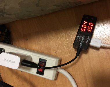

You need this tool which can find easily on Ebay
usb current and voltage tester | eBay
Normally with a Samsung adapter of 5 Volts, 2 Amps output you should have at least a reading of 5 V, 1.5A at the USB tester.
Test one by one until you find the problem :
1- Different adapters
2- Different USB cables
If you have the same low Amps with different cables and adapters , reading like under 1.5A or zero Amp, they are not the source of problem. If new one is good, the other is bad, you will know which part is defective.
3- If neither adapter or cable is bad, the next is test USB charging port.
4- If USB charging port still not the problem, then you need to check battery connector if there is any crack at solder joints to motherboard. This one requires skill if you need to re solder the battery connector. Battery connector is the one that connected battery cable to mainboard.
If all of the above are not the problem, then you have a bad mainboard.
