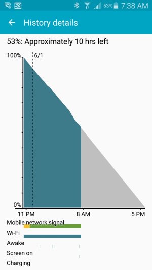

We need this battery picture, with the graphs at the bottom.
Uploading screenshot instructions are in belodion's post above.
Taking a screenshot is done by holding the home and power button at the same time until you hear the screenshot taken.

Re: Samsung s4 battery suddenly draining (about 4 months old)
This is it. I went to bed with 100% charge and woke up to 54%. I had my son look at the phone this morning and he said he cannot figure out any reason for the fast battery drain. My daughter has the same phone and said hers did that for a while and then went back to keeping the charge after an update. I wonder if something updated and caused the problem. I hope it will fix itself.
I see no reason for the drain. I would set WiFi to not scan and turn off when asleep (in advanced WiFi settings) other than your WiFi, the phone is sleeping well.
Did you clear cache or reset after the update to lollipop? How long ago did you update to lollipop?
