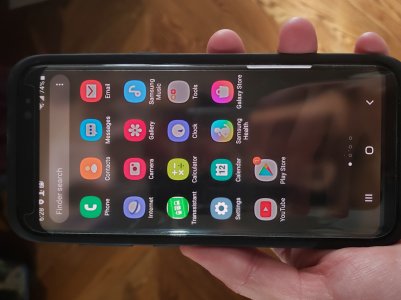

Please find attached.

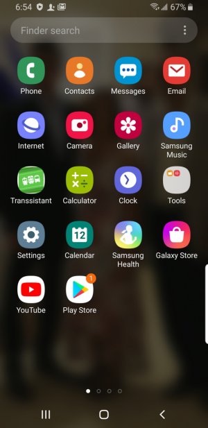

When taking a screenshot from the phone, everything is displayed correctly and nothing is cut off or shifted.
So i had to take a photo using an external camera. I hope this helps with the investigation.
screenshotting using gestures gave the same output. When opening the photo on the computer it doesnt show as shifted.
Please find attached a screenshot of the phone screen.

Aha! Glad you figured it out. Upon closer inspection of that photo you posted, I should've thought of that myself!
