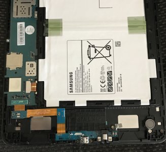

With the known working USB cable and adapter, you should get at least 1.5 Amp.
If your charging current is under 1 Amp with alternate cable and charger, the USB sub PCB must be replaced.
It's a simple replacement. This is the USB sub PCB after removing the rear cover and two speakers
https://rover.ebay.com/rover/1/711-...31&hash=item41c4ab9591%3Ag%3A7qMAAOSwfpVZFCI9

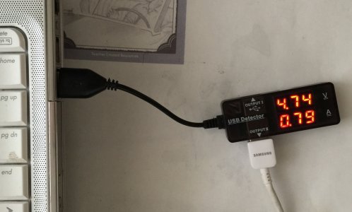

Don't confuse between not charging and black screen. When charging , the battery icon should show up if pressing the HOME button. Dead screen will show nothing but you can verify the charging status by the tool I mention above.
Don't ever use a computer's USB port for charging, its max current is only 0.8 Amp like this
