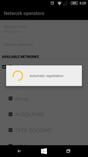

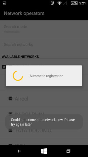

The issue is weird, it works absolutely fine on 3G but never registers on 2G / GSM only. t tries to register...even shows up in manual search as home network...but does not register - even no error...see screenshots.
this is purchased from dubai and using it in India. its absolutely unlocked as checked in service info menu as well

Thanks for the reply. tried that and though i can see the option to select Vodafone 2G (it even has an home icon besides it) i am unable to register...keeps trying to 'registering on network' and finally says 'unable to connect to network, try after some time'
