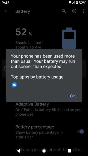

This UNNAMED app is draining my battery. I haven't used my phone since I had a new battery installed, yet it is halfway empty halfway thru the day. I charge it fully, then it sits. I've put the SIM card in a different phone and put the Pixel 2 in Airplane Mode.
What is this Mystery App and why is this new battery draining like I'm watching video or using Waze GPS all day?

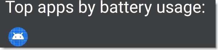

Here's the full screenshot:

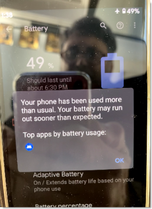

It took hours to fully charge. When I started it at 100% battery today, after less than an hour it was at 61%.
The Battery Setting again shows this Mystery App as the one that is using most of my battery. Ugh. It's fallen to 49% and, by now, might be out of juice.
See:
