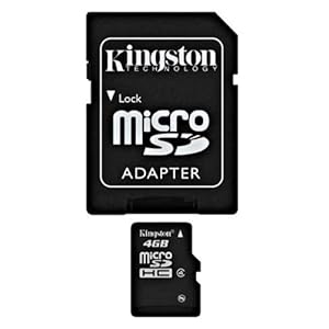

Ok, I'm putting my trust in Borgey and just ordered this card from amazon -
About $11 with shipping

The pny 4gb class 4 works great, I put about 15-20 hours in trying every Sandisk I had(about 7 - 8) and after 4 tries with the pny, I had root!

I tried 7 or 8 different sandisk sd cards and after 15 or so hours of trying every method out there, I bought a 4gb class4 pny sd card and it worked on the fourth try. The sd card may be the most important aspect of getting root. The ones that I've heard work the best are the one that I mentioned, the 2gb pny and 4gb kingston class 4. You can get any of those at Fred Meyer or Wall Mart, they are very common cards and fairly cheap. Good luck.

Is there any way of telling, from the packaging, what class a card is? I am going to Best Buy after work to look for one and want to know what I am looking for.
The last few cards I've bought on the top right corner of the packaging it says the class. To people with highspeed cameras it's important to them so it will be somewhere on the packaging.
