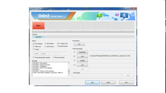

Downloading the firmware again isn't going to do any good - Odin is reporting that there's no PIT partition. Until that's fixed the rest is a waste of time.
If you do a Google search you should be able to find a source for the PIT file (be sure you get one for the memory size of your device - 16GB or 32GB); you'll load it using Odin (but you'll use the PIT button rather than the PDA button).

BE IT DURING HOURS Get PIT for mapping.....
