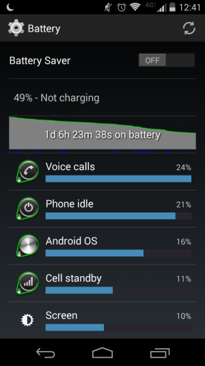

I'm having significant Android OS battery drain on unlocked T-Mobile 4.4.3. Does anyone know a fix?
