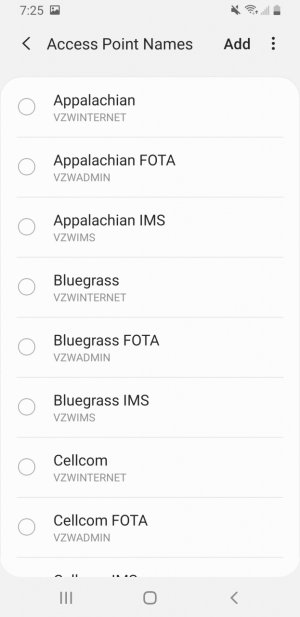

Does it populate a APN?
Have you tried another sim in the phone?
I have tried a lot of APN settings. Both with guidance of TW (before switching) and then Visible's support and settings (that should work) I've found online.
Current status is if I reset the network settings, the phone auto populates with a list of hundreds of different APN but none of the select automatically. If I create a new one with the settings Visible's support says to use (just VZWINTERNET but no other settings changed) then all the others disappear as soon as I click save until I reset the network settings and then theh come back. I've tried just selecting various ones of those but I really dont know what to look for there or if any specific ones are the ones I should be trying.

I haven't seen putting a sim give lot of options on APN , usually the sim you put automatically puts just the one for its provisions.
With TotalWireless it was as you describe. This behavior is new since the switch to Visible but their support seems to think it's normal.

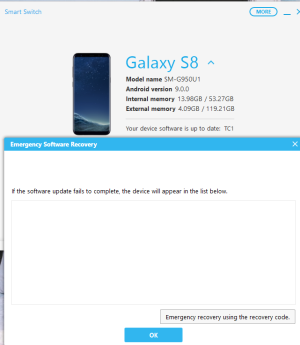

Samsung Smart Switch to reinstall stock firmware
I can't figure out how to make this work. Following the guide, everything seems to work with the app except the firmware installation. I can do backups, it shows the correct phone, I even tried reinstalling the device drivers for the "more menu" But the Emergency Software Recovery screen never populates (see attachment). Everything I've found online seems to think that the box should populate with my phone to select before clicking ok.

Also with visible sim right next to APN 3 dots upper corner should say reset APN ? Do that with that sim in
This doesn't seem to help. The instructions I found for download mode actually boot into safe mode on an S8 but SmartSwitch refuses to work in this mode because you cant access the smartswitch app on the phone.
Go to top corner where it says more> then tap preferences >updates> check the box where you number is and above it will show updates when they are available for your device
Yes, every indication I have anywhere in the smartswitch app is telling me that the phone is up to date and there is nothing I can install.
That resets it back to the full list of APNs but none are automatically selected.Screenshot_20200501-072503_Settings[1].jpg
Smart switch only works when phone on , download mode is for flashing in odin
That resets it back to the full list of APNs but none are automatically selected.View attachment 319920
So none of those work when you select?
The list has hundreds of APNs. I've only tried a few of them but the ones I've tried have not worked.
