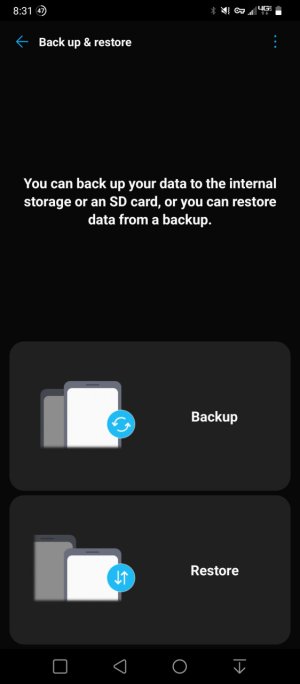

If you still have your old LG phone, I would try going into the main settings and use the search bar for "backup and restore." Hopefully you'll find a setting that leads you to a screen similar to this screenshot (from my V60, yours may be different). Try to restore from there, so the phone will know what to look for on the card, assuming the backup file is still on there. If that is successful, then go through the above process to manually backup everything you need and transfer that to the new phone.
