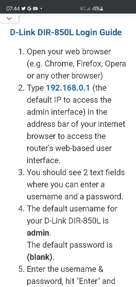

I'm not sure which is the modem and which is the router but one is Onu-Huawei-HG8240w and the other is D-Link DIR-850L.
Here is information on your router. It is the D Link device.
https://www.192-168-1-1-ip.co/router/d-link/dir-850l/6110/
