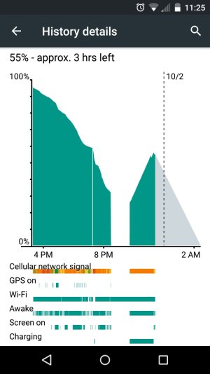

Battery drain was crazy fast. I'll chalk it up to first day setup, even though I had it plugged in intermittently. The most shocking thing was seeing the phone shutdown by itself sitting on my desk when I had 30% a few minutes earlier and the screen was off and phone was idle (see attached screenshot - does that confirm what occurred?). I plugged it in with the phone off and it showed the battery meter completely empty (I left it off for a while until powering it back on).
