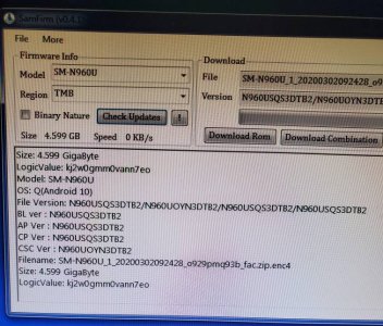

Both the phone, and smart switch say my software is up to date (android 9). I've pretty much been a Nexus, and Pixel guy so i don't know anything about Odin. Is this anything like rooting?
No nothing like rooting.
Odin is a flash tool :
You download the firmware and tool , extract their files and load into Odin to update to that firmware , shouldn't take more then 10 to 15 minutes after everthing download . Pretty straight forward
Your welcome! Just tag my name if you need any help or questions about it .
