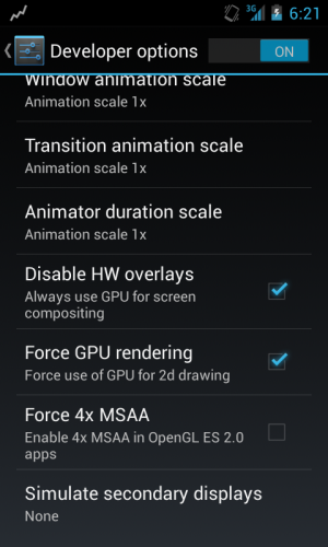

update for correct black screen probleme (on galaxy tab 2 7.0 for instance)
For all the ones who have a black screen, there's something in the description wich I overread:
** ICS+ devices: Make sure HW Overlay is disabled and "Force GPU Rendering" is enabled from the device's developer options menu
With this, the app worked perfectly!
I've got the same issue, seems to record fine, but when you go to play back the video, it's all black screen.
Already checked developer option settings....

When I first got it on my Nexus 10 it would either record the record button screen or after the recording I wouldnt be able to open it at all. Then after checking off "Disable HW Overlays","Force GPU Rendering", and " Force 4x MSAA" I was fianlly able to record, and watch the video when it was moved on my computer. Sadly there is still a problem with the inverted colors. I know you replied saying that it is a "kernel" problem (have no i dea what that means) but he didnt post how to fix it. Plz respond ASAP.

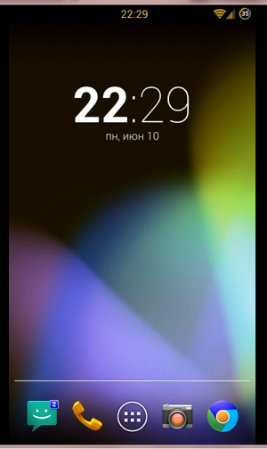

I SGS3 firmware AOKP. And after the recording, the video becomes:
I tried to write a Z-recorder - video with him in order.
Please help!
And also, greetings from Russia!
