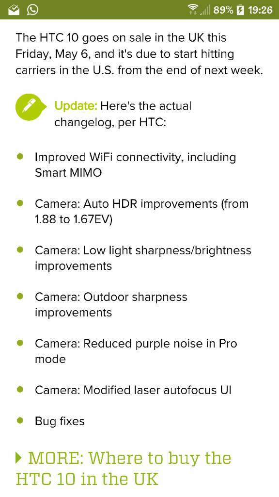

Same as OP but the camera app was updated today (US). I'll wait for the next 1.3x software update before I talk to HTC about replacing it. Although it is very disappointing that the laser auto-focus would just mess up like that.
Clean the auto focus and it will work
Yeah it helps a bit but it shouldn't be this sensitive. If the LG G5 doesn't have any issues this shouldn't either.
http://www.slashgear.com/htc-10-update-brings-camera-tuning-and-better-wi-fi-02438455/

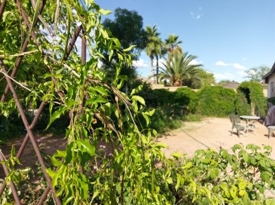

I tried to trick it to see if I could replicate the problem but no issue here. First photo focused on the ivy, 2nd is focused on the palm trees, about 100ft away.
View attachment 226908View attachment 226909
Did you let the autofocus handle it or did you manually focus? Manual focus works fine for me, autofocus on far-away objects doesn't, it just makes the entire picture blurry while it tries to focus but fails.
Mine works fine, first thing I did after buying the phone was testing the camera.
Autofocus, and I just tapped to focus. I was even able to tap and focus on the trees in the far background but it made almost everything else look out of focus (save for the far background) so I didn't bother to post it.
I haven't tried the manual focus yet.
By manual focus that's what I meant, sorry. Without tapping to focus, and having the phone look into a large distance with nothing else in front of it, do you get a blurry image (especially in a dimly lit room).
