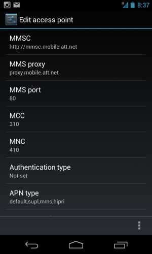

I received my Nexus 4 on Friday and moved the SIM from my LG LTE device (LG Escape) over to the Nexus 4. I called my carrier (AT&T) and told them I had a new HSPA+ device, gave them the IMEI, etc and they told me to restart my phone and all would be well. Well, things worked but the data network was too slow and I could see I was not getting access to the HSPA+ network. I verified my settings under APN were the wap.cingular.com ones. I called back the next day and they admitted they had set me up under the blackberry plan so they corrected that, and said to reboot and everything would be good to go. Of course, it still wasnt right. My APN settings still were the same and I had no HSPA+ network. I then manually edited my APN settings to the ones that I saw in another thread so that HSPA+ would work properly (see attachment) and voila! I had HSPA+ network access and all seemed well.
