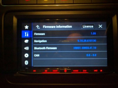

I updated my F77DAB using the Avicsync link.
Word of warning my initial USB stick failed the update for some reason. So I tried another and it worked. I was concerned I had damaged my head unit and would have to return it to pioneer. I would recommend anyone who does the update has a back up USB stick or SD card just in case.
As if I had not I would not be happy now!
