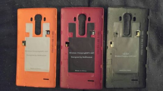

I have 3 leather backs with NEwisdom stickers on them, and all 3 work perfectly. Did you make sure to remove the existing NFC sticker off of your back before installing the QI sticker?
